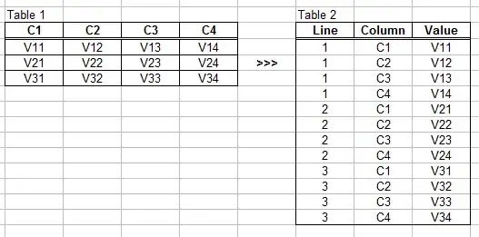

I got a set of tables which have been imported into a database by transforming them like shown in the following picture:
Table Transformation
Now it is necessary to get the former tables back. Unfortunately the guy who did the importing finished school and is thus is unavailable. Therefore I was asked to find an SQL-based solution to back-transform the tables. I would be able to write a small tool to solve this problem, but I've got no idea how to solve this with SQL.

Something like this might do the trick (here's the SQLFiddle)
SELECT
Line,
MAX(CASE WHEN `Column` = 'C1' THEN `Value` END) AS C1,
MAX(CASE WHEN `Column` = 'C2' THEN `Value` END) AS C2,
MAX(CASE WHEN `Column` = 'C3' THEN `Value` END) AS C3,
MAX(CASE WHEN `Column` = 'C4' THEN `Value` END) AS C4
FROM YourTable
GROUP BY Line
Like Sascha suggested in their answer, you might want to consider either creating this as a view, or creating a view that looks like Table 2 once you've finished putting the table back to how it was. That should prevent this kind of problem popping up again in the future.

For SQLserver you could simply use SELECT...PIVOT
For MySQL the problem has been addressed here: https://stackoverflow.com/questions/1241178/mysql-rows-to-columns
A better solution than pivoting the data into a table, would be the usage of a pivot VIEW and leaving the tables unpivoted, btw.
