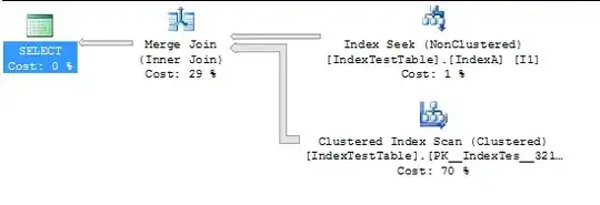

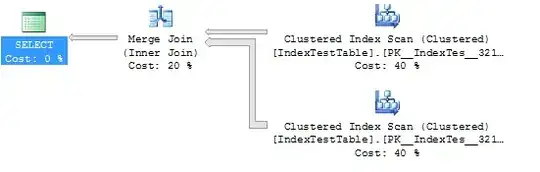

Now query 1, which is improved (only slightly but the improvement is consistent) is:
SELECT *
FROM   IndexTestTable I1
       JOIN IndexTestTable I2
            ON  I1.ID = I2.ID
WHERE  I1.Name = 'Name1'
Stats and execution plan without Index (in this case the table uses the default clustered index):
(5000 row(s) affected)
Table 'IndexTestTable'. Scan count 2, logical reads 5580, physical reads 0, read-ahead reads 0, lob logical reads 0, lob physical reads 0, lob read-ahead reads 0.
(1 row(s) affected)
 SQL Server Execution Times:
   CPU time = 109 ms,  elapsed time = 294 ms.
Now with Index enabled:
Table 'IndexTestTable'. Scan count 2, logical reads 2819, physical reads 0, read-ahead reads 0, lob logical reads 0, lob physical reads 0, lob read-ahead reads 0.
(1 row(s) affected)
   CPU time = 94 ms,  elapsed time = 231 ms.

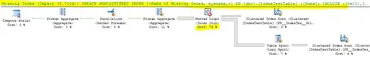

With clustered index enabled:
(1 row(s) affected)
Table 'IndexTestTable'. Scan count 4, logical reads 60, physical reads 0, read-ahead reads 0, lob logical reads 0, lob physical reads 0, lob read-ahead reads 0.
Table 'Worktable'. Scan count 0, logical reads 0, physical reads 0, read-ahead reads 0, lob logical reads 0, lob physical reads 0, lob read-ahead reads 0.
Table 'Worktable'. Scan count 1, logical reads 155106, physical reads 0, read-ahead reads 0, lob logical reads 0, lob physical reads 0, lob read-ahead reads 0.
(1 row(s) affected)
   CPU time = 17207 ms,  elapsed time = 17337 ms.

What is the Nested Loop join which is taking most of the time and how to improve its execution time?
There is little to be done to improve the performance of the cross join operation itself; nested loops is the only physical implementation possible for a cross join. The table spool on the inner side of the join is an optimization to avoid rescanning the inner side for each outer row. Whether this is a useful performance optimization depends on various factors, but in my tests the query is better off without it. Again, this is a consequence of using a cost model - my CPU and memory system likely has different performance characteristics than yours. There is no specific query hint to avoid the table spool, but there is an undocumented trace flag (8690) that you can use to test execution performance with and without the spool. If this were a real production system problem, the plan without the spool could be forced using a plan guide based on the plan produced with TF 8690 enabled. Using undocumented trace flags in production is not advised because the installation becomes technically unsupported and trace flags can have undesirable side-effects.

The main thing you are missing is that although the plan using the nonclustered index has a lower estimated cost according to the optimizer's model, it has a significant execution-time problem. If you look at the distribution of rows across threads in the plan using the Clustered Index, you will likely see a reasonably good distribution:
Scan plan
In the plan using the Nonclustered Index Seek, the work ends up being performed entirely by one thread:
Seek plan
This is a consequence of the way work is distributed among threads by parallel scan/seek operations. It is not always the case that a parallel scan will distribute work better than an index seek - but it does in this case. More complex plans might include repartitioning exchanges to redistribute work across threads. This plan has no such exchanges, so once rows are assigned to a thread, all related work is performed on that same thread. If you look at the work distribution for the other operators in the execution plan, you will see that all work is performed by the same thread as shown for the index seek.
There are no query hints to affect row distribution among threads, the important thing is to be aware of the possibility and to be able to read enough detail in the execution plan to determine when it is causing a problem.

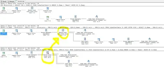

It is not really a question of the index, it is more a badly written query. You have a only 100 unique values of name, this leaves a unique count of 5000 per name.
So for each line in table 1 you are joining 5000 from table 2. Can you say 25020004 lines.
Try this, note this is with only 1 index, the one you listed.
    DECLARE @Distincts INT
    SET @Distincts = (SELECT  TOP 1 COUNT(*) FROM IndexTestTable I1 WHERE I1.Name = 'Name1' GROUP BY I1.Name)
    SELECT I1.Name
    , @Distincts
    , SUM(I1.val1) * @Distincts
    , SUM(I1.val2) * @Distincts
    , MIN(I2.Name)
    , SUM(I2.val1)
    , SUM(I2.val2)
    LEFT OUTER JOIN
        SELECT I2.Name
        , SUM(I2.val1) val1
        , SUM(I2.val2) val2
        FROM IndexTestTable I2
        GROUP BY I2.Name
    ) I2 ON  I1.Name = I2.Name
    GROUP BY  I1.Name
And time:
    SQL Server parse and compile time:
       CPU time = 0 ms, elapsed time = 8 ms.
    Table 'IndexTestTable'. Scan count 1, logical reads 31, physical reads 0, read-ahead reads 0, lob logical reads 0, lob physical reads 0, lob read-ahead reads 0.
       CPU time = 0 ms,  elapsed time = 1 ms.
    (1 row(s) affected)
    Table 'IndexTestTable'. Scan count 2, logical reads 62, physical reads 0, read-ahead reads 0, lob logical reads 0, lob physical reads 0, lob read-ahead reads 0.
       CPU time = 16 ms,  elapsed time = 10 ms.
You cannot blame SQL indexes for badly formed queries
