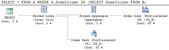

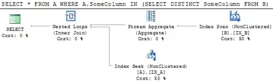

When wondering about things like this you should compare the execution plans for your queries.
The shape of the execution plan for your query will of course differ depending on how many rows you have in your tables and what indexes is defined.
One scenario that shows there is no difference in performance is when there are substantially more rows in A than there are in B. The optimizer will then choose B as the driving table in a nested loop join against A. In order to get a correct result back it has to use a Stream Aggregate on table B in both queries to get only the distinct rows from B. So in this case the distinct keyword has no impact on performance.
The execution plan for two other obvious cases to test, more rows in B than A and equal number of rows in the tables, also shows the exact same execution plan for the queries.
