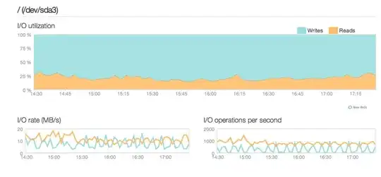

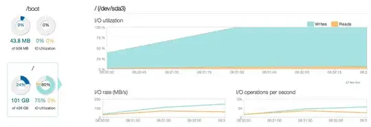

The situation I have a postgresql 9.2 database which is quite heavily updated all the time. The system is hence I/O bound, and I'm currently considering making another upgrade, I just need some directions on where to start improving.
Here is a picture of how the situation looked the past 3 months:
As you can see, update operations accounts for most of the disk utilization. Here is another picture of how the situation looks in a more detailed 3 hour window:
As you can see, the peak write rate is around 20MB/s
Software The server is running ubuntu 12.04 and postgresql 9.2. The type of updates are small updated typically on individual rows identified by ID. E.g. UPDATE cars SET price=some_price, updated_at = some_time_stamp WHERE id = some_id. I have removed and optimized indexes as much as I think is possible, and the servers configuration (both linux kernel and postgres conf) is pretty optimized as well.

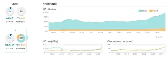

I have now upgraded my database server with four intel 520 SSDs instead of the old 15k SAS disks. I'm using the same raid controller. Things has improved quite a lot, as you can see from the following the peak I/O performance has improved around 6-10 times - and that's great!. enter image description here However, I was expecting something more like a 20-50 times improvement according to the answers and the I/O capabilities of the new SSDs. So here goes another question.
New question Is there something in my current configuration, that is limiting the I/O performance of my system (where is the bottleneck)?
