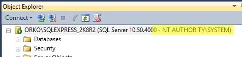

If you did not add your account to the sysadmin role during installation of SQL Server you will need to try and do that now. There are two options you can use with SQL Server 2008 R2:
  • Easiest way I have found is to follow the method discussed in my answer here. This method does not work on any higher versions of SQL Server. Illustration is below.
  • Your other option is to start SQL Server service in single-user mode. You can find those instructions in BOL here.

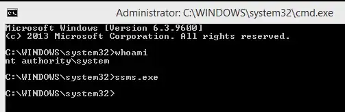

Using PsExec:
  1. Open command prompt (as administrator) to the directory where you downloaded PsExec.exe. Type in the command PsExec.exe -i -s cmd.exe.
  2. You can enter the command whoami to show that anything you open from this command prompt will open as the system account now.
  3. Simply type in ssms.exe to Open SSMS (SQL Server Management Studio) as the system account. You should have access now as a member of sysadmin to add your account to the sysadmin fixed server role.
enter image description here enter image description here enter image description here
