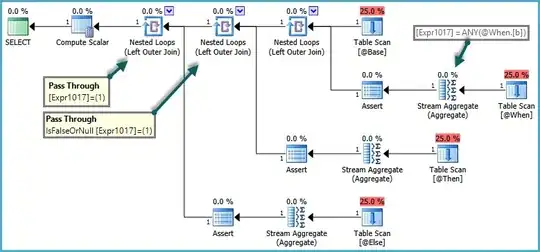

Subqueries in CASE expressions
Consider the following (perfectly legal) query:
DECLARE @Base AS TABLE (a integer NULL);
DECLARE @When AS TABLE (b integer NULL);
DECLARE @Then AS TABLE (c integer NULL);
DECLARE @Else AS TABLE (d integer NULL);
SELECT CASE WHEN (SELECT W.b FROM @When AS W) = 1 THEN (SELECT T.c FROM @Then AS T) ELSE (SELECT E.d FROM @Else AS E) END FROM @Base AS B;
The semantics of CASE are that WHEN/ELSE clauses are generally evaluated in textual order. In the query above, it would be incorrect for SQL Server to return an error if the ELSE subquery returned more than one row, if the WHEN clause was satisfied. To respect these semantics, the optimizer produces a plan that uses pass-through predicates:
Pass-through predicates
The inner side of the nested loop joins are only evaluated when the pass-through predicate returns false. The overall effect is that CASE expressions are tested in order, and subqueries are only evaluated if no previous expression was satisfied.

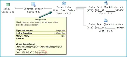

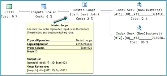

One of the possible execution plan shapes for this query is a direct implementation of that logical structure:
NLJ Semi Join with Probe
The final Compute Scalar evaluates the result of the CASE expression using the probe column value:
Compute Scalar expression
The basic shape of the plan tree is preserved when the optimizer considers other physical join types for the semi join. Only merge join supports a probe column, so a hash semi join, though logically possible, is not considered:
Merge with probe column
Notice the merge outputs an expression labelled Expr1008 (that the name is the same as before is a coincidence) though no definition for it appears on any operator in the plan. This is just the probe column again. As before, the final Compute Scalar uses this probe value to evaluate the CASE.

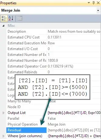

The problem is that the optimizer doesn't fully explore alternatives that only become worthwhile with merge (or hash) semi join. In the nested loops plan, there is no advantage to checking if rows in T2 match the range on every iteration. With a merge or hash plan, this could be a useful optimization.
If we add a matching BETWEEN predicate to T2 in the query, all that happens is that this check is performed for each row as a residual on the merge semi join (tough to spot in the execution plan, but it is there):
SELECT
    T1.ID,
    CASE
        WHEN EXISTS
            SELECT 1
            FROM #T2 AS T2
            WHERE T2.ID = T1.ID
            AND T2.ID BETWEEN 5000 AND 7000 -- New
        ) THEN 1
    ELSE 0
    END AS DoesExist
FROM #T1 AS T1
WHERE T1.ID BETWEEN 5000 AND 7000;
Residual predicate
We would hope that the BETWEEN predicate would instead be pushed down to T2 resulting in a seek. Normally, the optimizer would consider doing this (even without the extra predicate in the query). It recognizes implied predicates (BETWEEN on T1 and the join predicate between T1 and T2 together imply the BETWEEN on T2) without them being present in the original query text. Unfortunately, the apply-probe pattern means this is not explored.

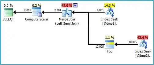

There are ways to write the query to produce seeks on both inputs to a merge semi join. One way involves writing the query in quite an unnatural way (defeating the reason I generally prefer EXISTS):
WITH T2 AS
    SELECT TOP (9223372036854775807)
        T2.*
    FROM #T2 AS T2
    WHERE T2.ID BETWEEN 5000 AND 7000
SELECT
    T1.ID,
    DoesExist =
        CASE
            WHEN EXISTS
                SELECT
                    T2.*
                FROM T2
                WHERE T2.ID = T1.ID
            ) THEN 1 ELSE 0 END
FROM #T1 AS T1
TOP trick plan
I wouldn't be happy writing that query in a production environment, it's just to demonstrate that the desired plan shape is possible. If the real query you need to write uses CASE in this particular way, and performance suffers by there not being a seek on the probe side of a merge semi-join, you might consider writing the query using different syntax that produces the right results and a more efficient execution plan.
