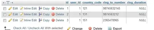

I am trying to access the ring_to_number from tbl_destinations that holds all the numbers. And field destinations has the comma separated ID like 1,3. but according to this query i just get the the result of id 1 i didn't get the result of id 3.
SELECT count( id ) AS totalDestination, group_concat( ring_to_number ) AS phoneNumbers
    FROM tbl_destinations
    WHERE id
    IN (
    SELECT destinations
    FROM tbl_rings_to_groups
    WHERE id = '1'
    AND user_id = '1'
Can anyone please tell me why i didn't get the destinations=>1,3 in SubQuery?
tbl_rings_to_groups:
tbl_destinations:

  • More details needed, add a few sample records for tbl_rings_to_groups and tbl_destinations. –  May 01 '13 at 10:49
  • @Mark i have updated my question please take a look.. – jogesh_pi May 01 '13 at 10:53
    "why i didn't get the destinations=>1,3 " - in fact, you did. But there is certainly no destination with an id of '1,3' in your database. You should fix your schema, not that query. – Mat May 01 '13 at 11:01
  • @Mat in tbl_rings_to_groups there is a field named destinations has the comma separated ID's of table tbl_destinations. And in above subquery return only id 1 not like 1,3 – jogesh_pi May 01 '13 at 11:03
    Yes, and that's exactly your problem. That column should have the same datatype as that of tlb_destinations.id, and not contain strings of any sort. – Mat May 01 '13 at 11:05
  • is tbl_destinations's id numeric or text? –  May 01 '13 at 11:06
  • @Mark tbl_destinations's id has datatype INT. – jogesh_pi May 01 '13 at 11:07
  • @Mat is there some alternative solution or i have to change the datatype? – jogesh_pi May 01 '13 at 11:09
