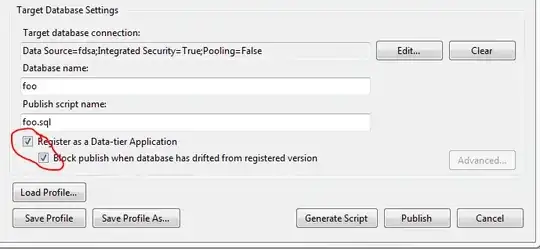

I had this error recently so I'll add my solution for anyone else who comes across this,
Turns out in my publish.xml I had RegisterDataTierApplication set to True. The first time I published the database it worked fine, but then I got the same error, as the database was already registered as a Data Tier application.
By setting to false (or unchecking the checkbox in the gui) it works fine.

Publish Database Profile
