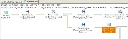

When executed, I get the following actual execution plan:
Actual Execution Plan
As you can see, almost 90% of the time is spent in the Nested Loops (Inner Join). Here's extra information on those Nested Loops:
Note that the table names don't match exactly because I edited the query table names for readability, but it's pretty easy to match (ads_alt_category = category). Is there any way to optimize this query? Also note that in production, the temp table #Ids doesn't exist, it's a Table Valued Parameter of the same 10'000 Ids passed on to the Stored Procedure.
