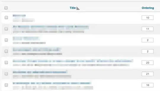

This is the approach that applications like Joomla take:
Example of Joomla's approach to ordering
You could argue that the interface here is bad, and that instead of humans directly editing numbers, they should use arrows or drag-and-drop—and you'd probably be right. But behind the scenes, the same thing is happening.
Some people have proposed using a decimal to store order, so that you can use "2.5" to insert a record in between the records at order 2 and 3. And while that helps a little, it's arguably even messier because you can end up with weird decimals (where do you stop? 2.75? 2.875? 2.8125?)
