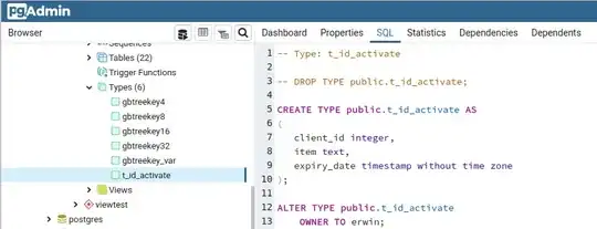

30
The default clients have functionality to cover that:
pgAdmin 4
Default GUI.
types in pgAdmin4
Make sure types are enabled in the object browser: File - Preferences - Browser - Nodes.
To the left you see user-defined types in the chosen schema. (Question 1)
The SQL pane to the right has the reverse engineered SQL script for the selected type. (Question 2)
More details in the other panes, like Dependents etc.
