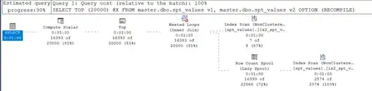

Viewing the live execution plan whilst it was running shows that rows are still flowing from the execution plan operators right up until the end (e.g. below is how it looked after a minute for me by which time it had returned 16,393 rows)

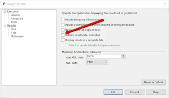

One other good thing to note (since you're asking this in regards to performance tuning) is you can discard the results of a query in SSMS. Doing so will help you more precisely see what the runtime is of a query excluding the consumer / client's rendering time, etc. I usually turn this on when I'm more interested in the runtime of the execution of the query itself:
SSMS - Discard Query Results
