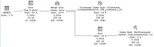

Instead, the query optimizer chose the following plan:
merge join plan
This plan uses your index to locate the user rows, sorts them in transactid order, merge joins them with all rows from the detail table, then sorts the result returning the top 10 rows. The sort on transactid is necessary for the merge join algorithm, which requires inputs sorted on the joining column(s). The detail table can be scanned in transactid order without a sort because that matches the clustered index order.
The optimizer chose this plan because it appeared to be cheaper than the alternatives it considered. SQL Server has little idea of the actual capabilities of your hardware, so it uses a generic costing model. Most of the time, this cost model provides a reasonable basis for choosing between plan alternatives.

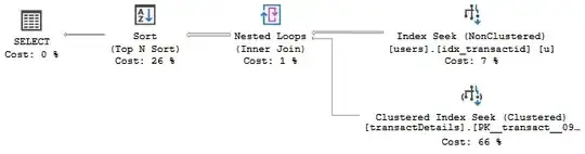

The plan is now:
FORCESEEK plan
It looks reasonable enough, but results in a separate seek into the clustered index on the details table for every row returned by the seek on the users table.
You mentioned that a single user might have as many as 500,000 rows in the users table. Even for many fewer rows than that, the estimated cost of many seeks quickly approaches the modelled cost of simply scanning the whole table.
If this seems counter-intuitive, remember that each seek has to navigate multiple levels of the clustered index b-tree. If the clustered index has five levels, that's 5 page accesses and a certain amount of CPU for a binary search at each level. Pages are not guaranteed to be in memory and might need to be brought in from disk. These page accesses are small reads (a single page) and so do not use read-ahead.
In addition, rows arriving from the seek on userid will not generally be in any particular order of the transactid values used to seek into the details table. SQL Server models this as mostly random access to the pages of the clustered index.
The scan alternative does not require a multi-level seek for every row returned. It can directly read whole pages of rows in clustered index order by following the next page pointers at the leaf level of the index. This results in many fewer page reads (logical or physical), less CPU usage, and potentially very efficient use of large read-ahead reads since the access is sequential (in index key order).
All these factors mean SQL Server assesses the merge join plan as lower cost, despite the extra sort. Depending on how much of the detail table is kept in memory and how fast your systems CPU is, you might find the plan with the FORCESEEK hint runs more quickly in practice. You might find it is slower. In any case, the above explains why SQL Server chose the plan it did.

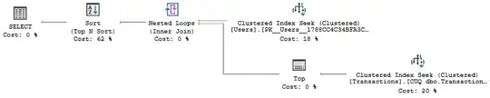

The execution plan is:
New design
This will be very fast, regardless of the number of rows in the tables, and scales well with the number of users searched for.
