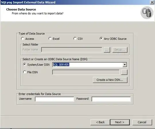

I tried Migration toolkit to import from SQL server to MySQL. But found SQLyog Import external data good. I could schedule the import process and also do necessary mappings to import to an existing table. Download from here.

SQLyog is a great tool, but the "import external data" feature is extremely slow. As in several orders of magnitude slower than MySQL Workbench. I wish SQLyog developers would fix the problem, because the interface is much more intuitive than Workbench. But unless you are only importing hundreds of rows than be prepared to wait hours or possibly days for the import to finish. – nextgentech Feb 11 '17 at 21:13
