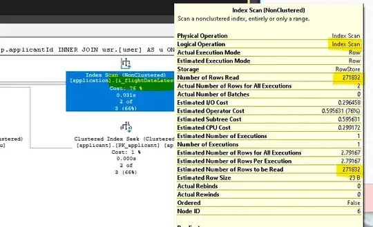

Could I change this in a way that my index can get used? The index actually get used, but it is a full scan.
It can also be seen here:

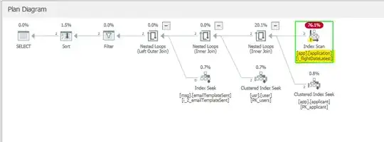

This is the full execution plan.
Unfortunately I cannot change the column called flightDateLatest from datetime to date to avoid convertion
Other than creating a computed column or change the schema, is there anything else that can be done to avoid reading the full table\index scan in this situation?

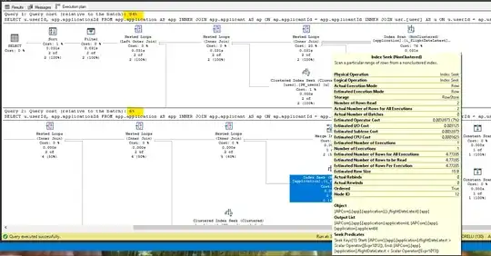

Update:
After the accepted answer, changed the query accordingly and now the index is used in a seek operation as you can see on the picture below.
Please note the 94% of cost of the original query to the 6% improved query:

You can add 6 weeks to your getutc...
and then test that particular day (flightDateLatest) to be greater or equal to DATEADD(week,6,Convert(Date, GETUTCDATE()))
and less then next day DATEADD(DAY,1,DATEADD(week,6,Convert(Date, GETUTCDATE())))

    app.flightDateLatest >= DATEADD(week,6,Convert(Date, GETUTCDATE()))
    AND
    app.flightDateLatest < DATEADD(DAY,1,DATEADD(week,6,Convert(Date, GETUTCDATE())))
