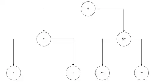

Further, lets assume I have 7 rows inserted. This is the balanced tree of the primary key:

I would guess that there is an exclusive lock on row 3,5,10. Is that right?
If that would be the case, then
SELECT * FROM t1 WHERE id=100 FOR UPDATE
would try to set an exclusive lock on row 10, because it scanned in the process to find 100. But that means, it has to wait for the other transaction to be finished.
This implies, any transaction that locks a row in table t1 will always first lock row with id 10. Thus, its not possible that two transactions lock two different rows in parallel.

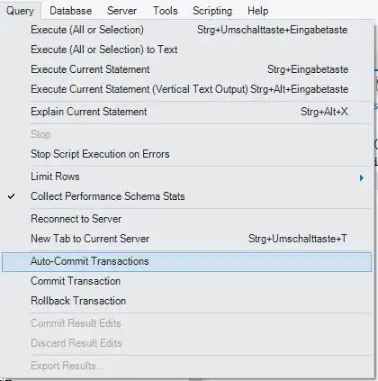

Ensure you have Auto-Commit Transactions turned off
MySQL Workbench - Query Options - Auto-Commit Transaction Off
