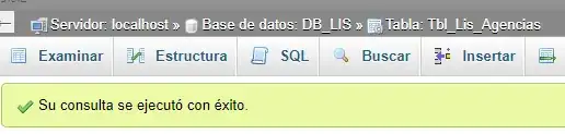

If I run this:
phpMyAdmin says that is was a succeful update:
but when I switch to the operation tab I see this again:
What I don't want to do and I am forced is to go to the terminal and run this:
ALTER TABLE Tbl_Lis_Agencias AUTO_INCREMENT = 5
Then I look at the operations tab again
Why isn't the operations tab updated in the first example?
The solution in this post is not useful, it is mandatory for me to do everything through phpMyAdmin, not through the terminal.
