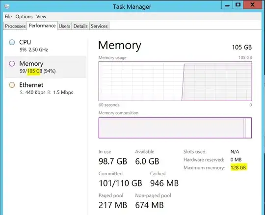

Within AWS, Many of our Database servers are being migrated from EC2 Instance to Bare Metal. (Correct me, If I am wrong) In Bare metal, there are two memory limits available for the VM hosted on Bare metal.
  1. Current total memory that is assigned to the VM hosted on Bare metal. (105 as per below screenshot)
  2. Max memory that can be assigned to VM by the Bare metal host in case more memory is needed by VM (Max Memory Available). (128 GB as per below screenshot)
Memory Details

  • Your answer is really helping, especially the last article. Regarding the comments you provided for point 2 - how can I check if dynamic is used memory for a VM in bare metal. Will the above screenshot gives any info related to that? Also any more information on how using it can cause problem to SQL Server will really help. – sachin-SQLServernewbiee May 29 '20 at 15:08
  • There are 2 purpose of posting this question: 1. Finding a process to determine the best possible value that can be used for MAX and MIN memory of SQL Server on bare metal? 2. Understanding exactly how SQL Server Memory will behave in normal / memory pressure situation at Host Level? – sachin-SQLServernewbiee May 29 '20 at 15:11
