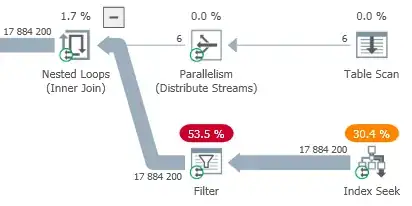

As you can see from the execution plan presented above, the cardinality estimator estimated the estimated number of rows in the Index Seek operation at 17,884,200 (corresponding to 2,980,700 per row from the outer part of the NL), which is quite close to the actual number.

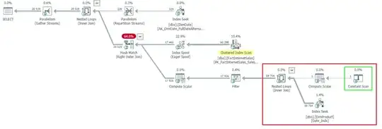

This query gives the following plan:
Seeing the logical form of the query, it is logical to assume that the expected number of rows of the Index Seek operation will remain the same, although I understand that the route for finding the plan is different, however, it would seem that the part highlighted in red has not changed, the same predicates, etc. , but Index Seek's estimate is now 664,506 (corresponding to 110,751 per line from the external part of NL), which is a gross mistake and in the production environment can cause a serious tempdb spill data.

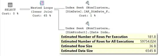

The query gives the following query plan: (1)

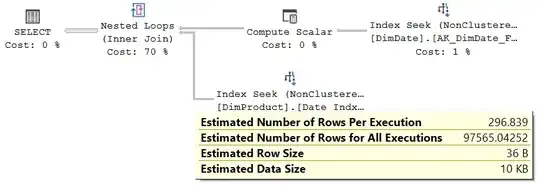

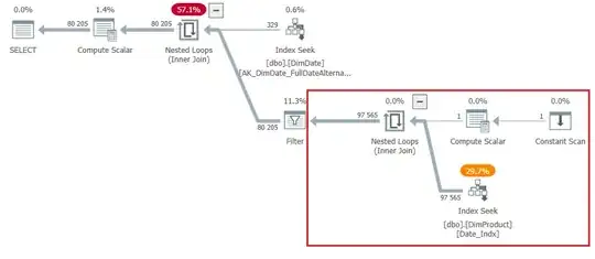

As you can see, the part of the query highlighted in red gives an estimate of 59,754 (~ 182 per row). Now I’ll demonstrate a query plan without a left outer join. (2)
As you can see the part of the query highlighted in red gives a score of 97 565 (~ 297 per row), the difference is not so great however, the cardinality score for the filter (3) operator is significantly different ~ 244 per row versus ~ 54 in the query with left outer join.
(3) – Filter predicate:

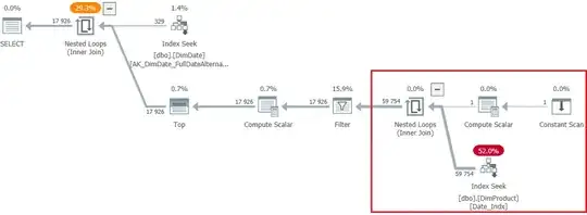

Which gives the following plan: (4)
As you can see, the estimation of the area highlighted in red coincides with the plan (1) and the PhyOp_Apply (x_jtInner) operator in the tree of physical operators.

Notice the estimate of 296.839 rows on the DimProduct seek.
This is a consequence of the join cardinality estimate being computed as 97,565.2 rows (using histograms). The filter on DimDate passes through 328.68 rows, so the inner side must produce 296.839 rows per iteration on average to make the maths work out.
If a hash or merge join were possible for this query (which it isn't, due to the inequality), the DimProduct table would be scanned, producing all of its 606 rows. The result of the join would still be 97,565.2 rows.
