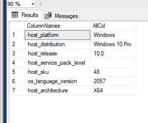

I sometimes have to unpivot tables, that means, converting all columns into rows.
Generally that becomes a table with 2 columns (just to simplify things) - the first is the column name and the second is the column value. . In the example below I found out manually by looking at the column types in the original table, that the best column to store the value is nvarchar(256).
Questions:
How could I find this "the best value to use as the values column type is nvarchar(256)" out dynamically?
I know I could use sql_variant for the values column type? In this case can I ignore the collate database_default?
That would be an expensive overkill - and I want to avoid that:
sql_variant can have a maximum length of 8016 bytes. This includes both the base type information and the base type value. The maximum length of the actual base type value is 8,000 bytes.
-- Unpivot the table - SUCCESSFUL
IF OBJECT_ID('TEMPDB.DBO.#UNPIVOT') IS NOT NULL
   DROP TABLE #UNPIVOT
CREATE TABLE #UNPIVOT(
    [ColumnNames] [nvarchar](128) NULL,
    [AllCol] [nvarchar](256) NULL
INSERT INTO #UNPIVOT([ColumnNames],[AllCol] )
SELECT
     ColumnNames
    ,AllCol
    --INTO TABLEBACKUPS.DBO.UNPIVOT_
FROM (
        select
                [host_platform]                   = CAST (host_platform collate database_default as [nvarchar](256)),
                [host_distribution]               = CAST (host_distribution collate database_default as [nvarchar](256)),
                [host_release]                    = CAST (host_release collate database_default as [nvarchar](256)),
                [host_service_pack_level]         = CAST ([host_service_pack_level] collate database_default as [nvarchar](256)),
                [host_sku]                        = CAST ([host_sku]  as [nvarchar](256)),
                [os_language_version]             = CAST ([os_language_version]  as [nvarchar](256)),
                [host_architecture]               = CAST ([host_architecture] collate database_default as [nvarchar](256))
       from
       sys.dm_os_host_info
      ) Radhe
UNPIVOT
AllCol
FOR ColumnNames IN (
                      host_platform
                     ,host_distribution
                     ,host_release
                     ,host_service_pack_level
                     ,host_sku
                     ,os_language_version
                    ,host_architecture
) unpvt
SELECT [ColumnNames]
      ,[AllCol]
FROM #UNPIVOT
