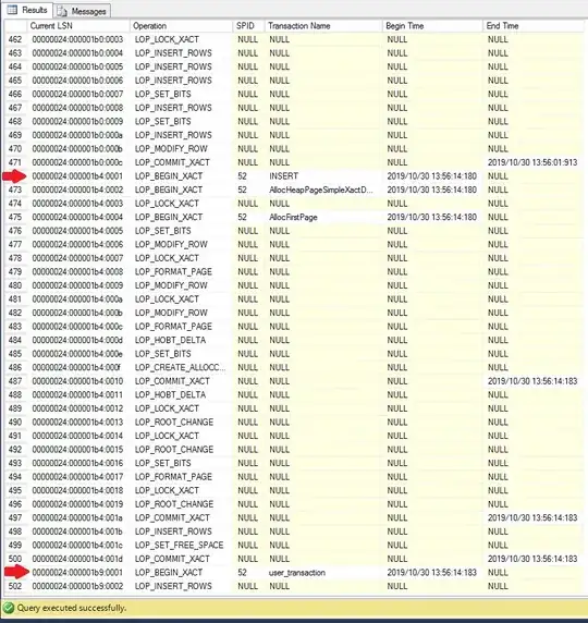

Observe that the second insert is under a BEGIN TRAN that hasn't been committed yet. Next we'll use the function [fn_dblog to check the content of the log file before taking a log backup.
SELECT [Current LSN], [Operation], [SPID], [Transaction Name], [Begin Time], [End Time] FROM fn_dblog(NULL, NULL);
On the picture we can see LSNs related to the first and second INSERT

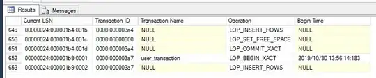

A log backup was taken and we can read its content with the function fn_dump_dblog using the following query:
SELECT [Current LSN], [Transaction ID], [Transaction Name], [Operation], [Begin Time]
FROM fn_dump_dblog (NULL, NULL, N'DISK', 1, N'C:\Program Files\Microsoft SQL Server\MSSQL14.SQL2017\MSSQL\Backup\MyDB_LOG.trn',
DEFAULT, DEFAULT, DEFAULT, DEFAULT, DEFAULT, DEFAULT, DEFAULT, DEFAULT, DEFAULT, DEFAULT, DEFAULT, DEFAULT, DEFAULT, DEFAULT,
DEFAULT, DEFAULT, DEFAULT, DEFAULT, DEFAULT, DEFAULT, DEFAULT);
Second Query result
As we can see those LSNs related to the unfinished transaction actually are on the transaction log backup even though they were not committed. The catch is that as Microsoft says
The transaction log is a critical component of the database. If there is a system failure, you will need that log to bring your database back to a consistent state.
Hence after performing a restore of that log backup the data related to those unfinished transactions will be rolled back to keep the database in a consistent state ( see Recovery and the transaction log).
