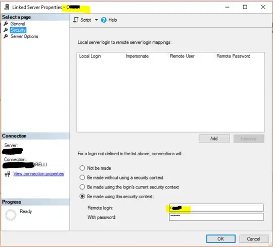

I have a linked server based in Italy server_italia that connects to a server based in Oregon USA ORDB1
we are on different but trusted domains.
The connection from server_italia to ORDB1 is made through a linked server using a sql server account that has a login and the required permissions on ORDB1.
I am a sysadmin and even domain admin in my domain, and my server_italia but I am only sysadmin inside the sql server on ORDB1.
There is a similar question:
How can I get my linked server working using Windows authentication?
but it does not provide the answer.
Here is my linked server:

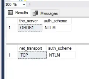

when I run the following queries on server_italia I get the following results:
SELECT [the_server]=@@servername,
auth_scheme
FROM sys.dm_exec_connections WHERE session_id = @@spid ;
SELECT net_transport, auth_scheme
WHERE session_id = @@SPID;
In Oregon I get this:
If my American colleagues get:

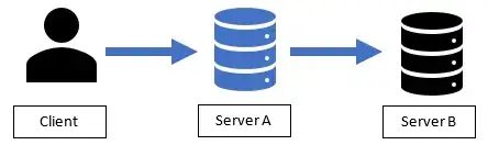

To help make my post clear (especially to anyone coming across it and not reading through your question), delegation is the ability of an intermediary service to hand off client credentials to a secondary service on behalf of the client. Represented visually, as follows:
In this case Server A is the intermediary service handing off the Client credentials to the secondary service, Server B. In your case, server_italia would be considered the intermediary server and ORDB1 would be the secondary service.

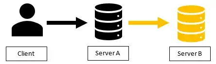

Unconstrained Delegation is the easiest configuration to setup, yet least restrictive approach. This configuration allows the Service Account running Server A to delegate any credential to any secondary service. This is visually represented in the image above with the blue arrows denoting no limitation on inbound client connection or secondary service that credentials can be delegated to. To configure this type of delegation on the intermediary account, you only need to set the following AD property (in addition to those listed above):
