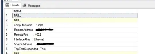

when I run the following command in the USA server:
 declare @sql varchar(1008)
 set @sql = 'powershell.exe -command Test-NetConnection sqlst -port 4022'
 EXEC xp_cmdshell @sql
I get a wonderful message saying that all the connectivity is fine as you can see on the picture below: The Ip addresses have been masked to protect the innocent.

As I said above when I run the following I get a good response:

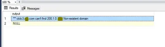

However, when I run nslookup using the IP address of sqlst - 200.1.0.xxx I get the below error:
 set @sql = 'powershell.exe -command $ns = (nslookup.exe 200.1.0.xxx )[-4..-3]
$ns'
Basically that says, domain controller cannot find the sqlst ip address

    From the US SQL server, can you perform a nslookup <IP Address of European DB>? If that is successful and you're still getting the DNS lookup failed error in your service broker messages, try running an ipconfig /flushdns command locally on the US database server in case you've got some bad DNS routes cached. See if that helps. If that works, I'll convert this to an answer, but if it doesn't, we will at least guarantee it's not a bad DNS route. – John Eisbrener Jun 24 '19 at 16:36

  • at the moment bad DNS seems to be the case, I will escalate to management and tomorrow hopefully post an update. end points have been granted permissions yes. – Marcello Miorelli Jun 24 '19 at 17:51
this problem was actually caused by a particular way the trusted domains US-Europe was configured, (beyond the scope of this question) however, using the scripts that you can see on the original question, then working with the sysadmins, and then finding server names that could be authenticated on both ends (source and destination) resolved the case - after altering the routers as per this example:
