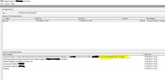

All goes on well, then while running a snapshot of a publication on transactional replication:
get an error that the folder where the publication is set to run the snap does not have the privileges enter image description here

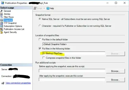

I check where the snapshot is set to be generated within the publication it is not where it should be enter image description here

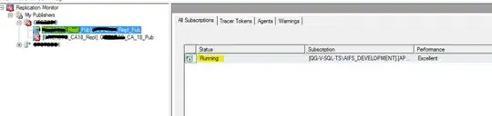

From my local ssms, I connect to the server where the publications are and run the following command to change the publication and set the snapshot folder to a different location:
the script below also marks that subscription for reinitialization and starts the snapshot agent.
use [my_database_publisher]
EXEC sp_changepublication
@publication = 'My_Publication_Pub', --Enter your publication name
@property = 'alt_snapshot_folder' ,
@value = 'G:\Backup\ReplData',
@force_invalidate_snapshot=1
GO
