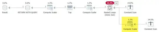

The (trivial) subquery introduced in the problematic case therefore results in an apply operator (nested loops join). To meet the second requirement, SQL Server initially places the expression dbo.test6(1) + dbo.test6(2) on the inner side of the apply:
highlighted compute scalar
[Expr1000] = Scalar Operator([dbo].[test6]((1))+[dbo].[test6]((2)))
...with the CASE semantics honoured by a pass-through predicate on the join:
[@i]=(1) OR [@i]=(2) OR IsFalseOrNull [@i]=(3)
The inner side of the loop is only evaluated if the pass-through condition evaluates to false (meaning @i = 3). This is all correct so far. The Compute Scalar following the nested loops join also honours the CASE semantics correctly:
[Expr1001] = Scalar Operator(CASE WHEN [@i]=(1) THEN (1) ELSE CASE WHEN [@i]=(2) THEN (2) ELSE CASE WHEN [@i]=(3) THEN [Expr1000] ELSE NULL END END END)

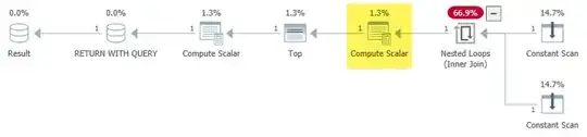

The problem is that the project normalization stage of query compilation sees that Expr1000 is uncorrelated and determines that it would be safe (narrator: it isn't) to move it outside the loop:
moved project
This breaks* the semantics implemented by the pass-through predicate, so the function is evaluated when it should not be, and an infinite loop results.
