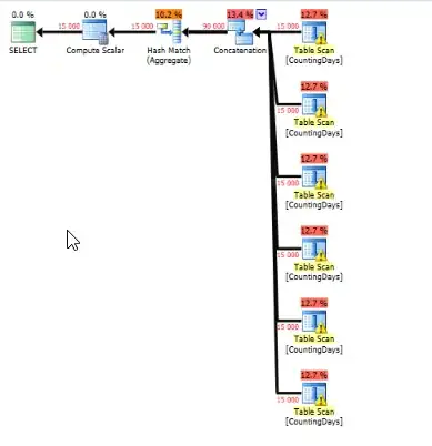

It could reduce the time you access the table, and possibly the execution time of your query.
If that is true will depend on the indexes on the table, the size of the table, ....
An example of executing your query on an unindexed heap:
While the rows returned are 15K, the residual I/O on the predicate is high, 120K rows for each table scan.
As you already know, adding an index could change this to a seek predicate.

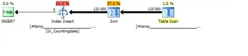

Reducing the time you would access the table can be done by using a temp table.
Insert the data
Add an index
Do index seeks on your temp table
Conclusion
While reducing the time accessing the table, the execution time in total was twice as long on my test server. To help you confirm if it is a solution for you, we would need the table definition, the actual query and additionaly the test data.
If it is not an option to share these things, then you could do the test yourself, and share the execution plans and the SET STATISTICS IO,TIME output.

SET STATISTICS IO, TIME ON;
select count(*), groupcolumn from (
select groupcolumn from CountingDays
 where countingdate < dateadd(day,-3,getdate()) and countingdate >= dateadd(day,-4,getdate())
union all
 where countingdate < dateadd(day,-4,getdate()) and countingdate >= dateadd(day,-5,getdate())
 union all
 where countingdate < dateadd(day,-5,getdate()) and countingdate >= dateadd(day,-6,getdate())
union all
 where countingdate < dateadd(day,-6,getdate()) and countingdate >= dateadd(day,-7,getdate())
 union all
 where countingdate < dateadd(day,-7,getdate()) and countingdate >= dateadd(day,-8,getdate())
union all
where countingdate < dateadd(day,-8,getdate()) and countingdate >= dateadd(day,-9,getdate())) a
group by groupcolumn
CREATE TABLE #temp(groupcolumn varchar(255), countingdate datetime2)
INSERT INTO #temp(groupcolumn,countingdate)
select groupcolumn,countingdate FROM CountingDays
CREATE INDEX IX_Countingdate on #temp(Countingdate) include(groupcolumn)
select groupcolumn from #temp
union all
 union all
union all
 union all
union all
DROP TABLE #temp
