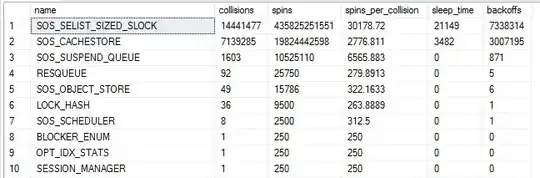

Throughput measured in hashes per second does not increase past 16 concurrent threads when testing on a 96 core server. I test by changing the number of concurrent MAXDOP 8 queries from 1 - 12. Testing with MAXDOP 1 showed the same scalability bottleneck.

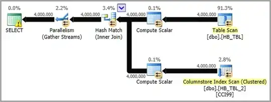

Execution plan
plan

Some quick thoughts on all of the methods:
  • CHECKSUM: very good scalability as expected
  • HASHBYTES: scalability issues include one memory allocation per call and a large amount of CPU spent in the OS
  • Spooky: surprisingly good scalability
  • Spooky LOB: the spinlock SOS_SELIST_SIZED_SLOCK spins out of control. I suspect this is a general issue with passing LOBs through CLR functions, but I'm not sure
  • Util_HashBinary: looks like it gets hit by the same spinlock. I haven't looked into this so far because there's probably not a lot that I can do about it:
spin your lock
  • Util_HashBinary 8k: very surprising results, not sure what's going on here
