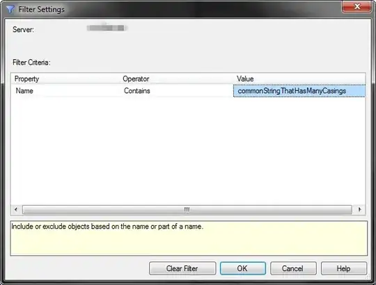

Preface: I am not referring to queries.
There are numerous places in SSMS that allow for filtering, such as the Object Explorer and Profiler, but these all treat filters as case-sensitive with no visible option otherwise, so if you search for contains 'ASDF' then values like "ASDF_MyEntity" are included but "asdf_MyEntity" are omitted.
For example, we have a lot of SQL Agent jobs on a large server, and I'm trying to use the Object Explorer to filter them by project name, which we always prefix the job names with. However, these appear as both uppercase and lowercase variants.
Another use case is searching for related stored procedure to a module among thousands of entries. If one is named inconsistently (e.g. PascalCase versus camelCase), the filtered search will omit it. This seems like quite an unnecessary hazard of phantoms for debugging.
Furthermore, the sorting in the Object Explorer places uppercase variants before lowercase (so uppercase Z comes before lowercase a) for every type of entity (e.g. table names, stored procedures, job names, etc.), so I either have to scroll around a lot, or check two different filters (or more if it's not all uppercase or all lowercase letters — 2len(name) times to be precise).
I realize I can just query jobs, tables, and other entities manually, but doing this is nonsensical given that SSMS exists, as its name is "SQL Server Management Studio."
Is there something I can do to make SSMS (and SQL Server Profiler) ignore case like every other Windows application? Perhaps I can change a collation setting locally?
Also, why was this decision made by Microsoft when implementing SSMS? I have found it to be only detrimental.

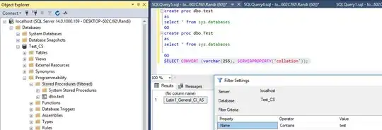

It also appears to not be possible on CS DB's on CI Servers:
As a result, we have the same issue as you noted in the added link.
Unless you find where the query is stored and change it, I don't think there is a way around it.

Name    Schema  Urn CreateDate  Owner   IsEncrypted ImplementationType  IsNativelyCompiled
TestCs  dbo Server[@Name='DESKTOP-602CJ92\  2019-01-28 20:05:28.220 dbo 0   1   0
