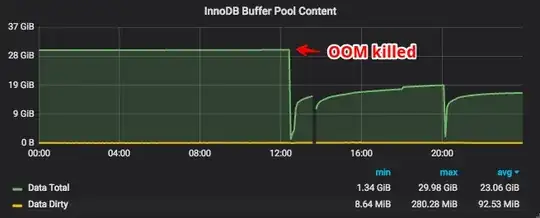

The last downtime happened yesterday. I have verified that the InnoDB buffer never crossed 30GB for the whole day.
Buffer Pool usage

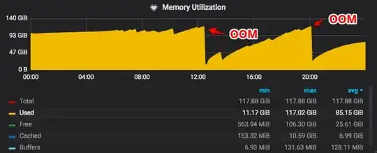

Memory used:
The both highlighted points are the maximum limit.

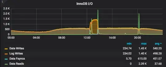

InnoDB IO

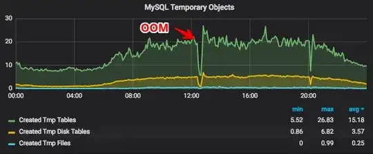

Temo Objects:
