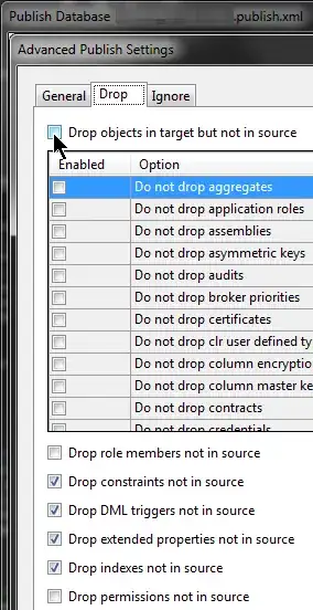

There is a setting on the "drop" tab of the advanced publish settings called "Drop DML Triggers not in source." This is checked by default, and thus triggers should be dropped by the publish process. This is true even if "drop object in target but not in source" is unchecked.
It sounds like this has been unchecked in your publish process. You can confirm that by looking for this element in your publish XML file (if that's how you're publishing):
<DropDmlTriggersNotInSource>False</DropDmlTriggersNotInSource>
Removing that element, or setting it to true, should resolve your issue without setting the undesirable "drop object in target but not in source" or having to use a pre-model script.

  • A column in the table with the trigger is being dropped, and a column in a table referenced by the trigger is being added. I don't even see why it's complaining about those changes because they don't appear to interfere with each other, because the trigger references neither column! The option to "drop DML triggers not in source" is also enabled. – Elaskanator Aug 27 '18 at 17:06
