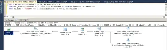

Here is my Estimated Execution Plan.
Estimated ExecutionPlan

Try modifying your query so it isn't overwriting values with the same value. It will reduce logging.
UPDATE t1
SET t1.fExclPrice = 521.95, t1.fInclPrice = 1
FROM dbo._evPriceListPrices AS t1
INNER JOIN dbo.StkItem AS t2 ON t1.iStockID = t2.StockLink
WHERE t2.Code = '108085R'
AND t1.iPriceListNameID = 1 AND t1.iWareHouseID = 5
--Dont overwrite records with the same values it generates extra logging
AND
    t1.fExclPrice IS NULL
    OR t1.fExclPrice <> 521.95
    OR t1.fInclPrice IS NULL
    OR t1.fInclPrice <> 1

insert your new prices into a temporary table
update the temp table from dbo.StkItem so that it has StockLink
the update dbo._evPriceListPrices from the temp table using a join on Stocklink
experiment with batch sizes 1000 might be faster or 100000 it depends on your server and the workload.

I've opted to process the SQL statements in batches. Each batch has a file size of up to 500kb. This is the most I could process as the server memory is at 98%, which impacts the number of statements I can run at a time.
After doing them in batches, I found that the updates complete in 1 hour. This is a dramatic drop in time from previous methods of updating. I was using the Pastel Evolution SDK before committing raw SQL.
This still was not fast enough for me.
I then decided to add a checkbox to allow the user to select which stock items they would like to update. This will fetch and updated selected stock items only, instead of updating the entire stock table.
At the end, it comes down to CPU Memory available. If you have enough memory, then you can process larger batches. Otherwise it would be better to update records that are marked for updating only.
