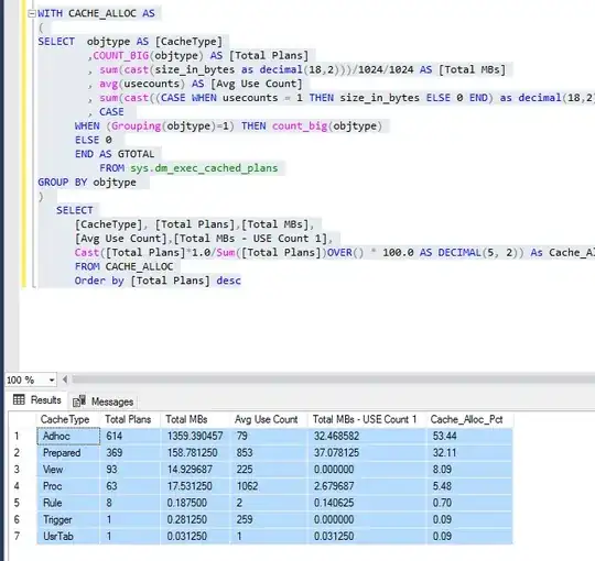

Recently I got to know that most of the queries are running fast, but at times some queries are running slow.So i checked for few queries and learned that the query plans are getting stored in the plan cache,but i see lots of plan for a each queries.Some plans are widely used with double digit execution count while a lot are single digit execution count.

I learned that my plan cache is being cleared out periodically because i see different counts for plan when i search for a query.Probably that is why serial plans generate ,because good plan gets removed and on subsequent execution serial plan gets into plan cache.
On analyzing the plan cache i learned that most of my queries are Adhoch and is that why plan cache is getting cleared.?
Any suggestions/solutions? Plan cache summary
Optmize for adhoc workload is enabled. Total RAM is 128 GB and max server memory is set to 126 GB
