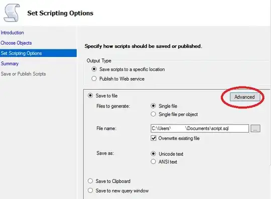

I really like David's answer and upvoted that for a programmatic way of doing things.
But you can try this today for a test-run in Azure via SSMS:
Right click your database --> Tasks --> Generate Scripts..
[Back Story] we had a junior DBA who upgraded all our test environments to SQL 2008 R2 while our production environments were at SQL 2008. It's a change that makes me cringe to this day. To migrate to production, from test, we had to generate scripts within SQL, using generate scripts, and in the advanced options we used the 'Type of Data to script: Schema and Data' option to generate a massive text file. We were successfully able to move our test R2 databases to our legacy SQL 2008 servers -- where a database restore to a lower version would not have worked. We used sqlcmd to input the large file--as the files were often too big for the SSMS text buffer.
What I'm saying here is that this option would probably work for you as well. You'll just need to do one additional step and search and replace getdate() with [dbo].getlocaldate in the generated text file. (I would put your function into the database before migration though).
(I never wanted to be proficient at this band-aid of a database restore, but for a while it became a defacto way of doing things. And, it worked every time.)
If you choose this route, be sure and select the Advanced button and select all the options you need (read each one) to move from the old database to the new database--like the defaults you mentioned. But give it a few test runs in Azure. I bet you'll find that this is one solution that works -- with a modicum of effort.
