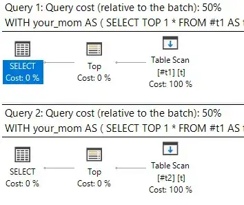

It doesn't appear that they do, but this really only applies to nested CTEs.
Create two temp tables:
CREATE TABLE #t1 (id INT);
INSERT #t1 ( id )
VALUES ( 1 );
CREATE TABLE #t2 (id INT);
INSERT #t2 ( id )
VALUES ( 1 );
Query 1:
WITH your_mom AS (
    SELECT TOP 1 *
    FROM #t1 AS t
also_your_mom AS (
    SELECT TOP 1 *
    FROM #t2 AS t
SELECT *
FROM your_mom;
Query 2:
WITH your_mom AS (
    SELECT TOP 1 *
    FROM #t1 AS t
also_your_mom AS (
    SELECT TOP 1 *
    FROM #t2 AS t
SELECT *
FROM also_your_mom;
Query plans:
NUTS
There is an overhead, but the unnecessary portion of the query is eliminated very early (during parsing in this case; the simplification stage in more complex cases), so the additional work is truly minimal, and does not contribute to potentially expensive cost-based optimization.
