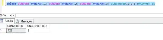

enter image description hereThis might be the simplest code to be written
select *
from b
where b.c1+b.c2+b.c3 not in (select a.c1+a.c2+a.c3 from a)
If column values are int try using convert for them: convert(varchar,b.c1)

    It may be simple but adding the 3 values is not correct way to compare triplets. This would match (1,2,3) with (3,1,2) and even (4,1,1) and (6,0,0) – ypercubeᵀᴹ May 21 '18 at 08:50
  • It may be simple but adding the 3 values is not correct way to compare triplets. This would match (1,2,3) with (3,1,2) and even (4,1,1) and (6,0,0)
    it wont, check my screenshot for example. @ypercubeᵀᴹ
    please change your votes if you agreed.
    – Nayyer May 22 '18 at 09:34
  • @Akina check my screenshot. it wont convert back when explicitly converted.
    – Nayyer May 22 '18 at 09:35
  • You are assuming varchar columns, so the + is doing concatenation, not addition. If your answer meant that assumption, it should have been explained (that it only works by using VARCHARs (or converting columns to VARCHARs first). – ypercubeᵀᴹ May 22 '18 at 09:36
    Still it would fail for various reasons. Even for varchar columns, this would match ('1', '2', '34') with ('1', '23', '4') and ('12', '3', '4') – ypercubeᵀᴹ May 22 '18 at 09:37
  • @ypercubeᵀᴹ i have already asked to convert if your datatype is int. – Nayyer May 22 '18 at 09:38
    The topicstarter do not specify his RDBMS, while Your solution is RDBMS-dependent. It fails in MySQL, for example. – Akina May 22 '18 at 09:39
  • Still it would fail for various reasons. Even for varchar columns, this would match ('1', '2', '34') with ('1', '23', '4') and ('12', '3', '4')
    agreed! thanks for the correction @ypercubeᵀᴹ
    – Nayyer May 22 '18 at 09:39
  • Also what @Akina commented. CONVERT() is not standard syntax (seems you are using SQL Server). The question has not been tagged so we don't know the DBMS. – ypercubeᵀᴹ May 22 '18 at 09:42
