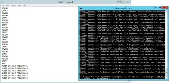

I'm trying to restore a database from a text file. I'm following the answer on this question. How do I restore a plain text postgres .backup file
But add: > c:\result.txt
psql.exe -U  sde sde < c:\backup\sde_04_06_2018.backup > c:\backup\result.txt
This seem to work but doesn't write the errors.
You get messages like this on the text file:
REVOKE
GRANT
SET
ALTER DEFAULT PRIVILEGES
But on the command windows you see error like this:
ERROR:  constraint "sde_layer_stats_version_id_fkey" for relation sde_layer_stats" already exists
ERROR:  constraint "xml_columns_fk1" for relation "sde_xml_columns" already exists
ERROR:  constraint "xml_columns_fk2" for relation "sde_xml_columns" already exists
ERROR:  constraint "xml_indextags_fk1" for relation "sde_xml_index_tags" already exists
The idea is save the error on the text file so I can review and decide if are something I need to handle.

I want help with how write the command line so I can save the output of the restore to a file.txt. So the create/insert/alter on the backup aren't relevant. And the image is just as reference, I also include the message as text just in case.
If you're asking how do you put the error to the "result file" too, you need to redirect STDERR as well as STDOUT or direct STDERR to STDOUT with 2>&1
psql.exe -U  sde sde < c:\backup\sde_04_06_2018.backup > c:\backup\result.txt 2>&1

  • Thanks Evan. But I just got the same result as before. – Juan Carlos Oropeza Apr 17 '18 at 20:29
  • @JuanCarlosOropeza try that (moving 2>&1 to the end) – Evan Carroll Apr 17 '18 at 20:31
    Perfect. Just for feedback. You answer direct to my comment instead of the question. Do you think my question wasn't clear enough? – Juan Carlos Oropeza Apr 17 '18 at 20:39
