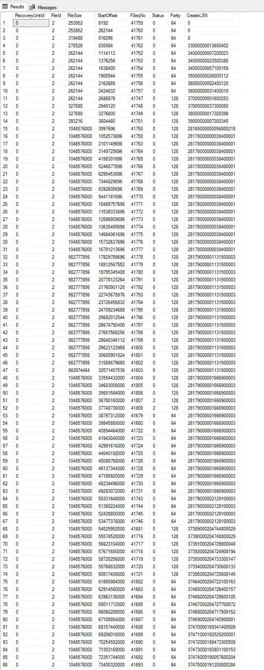

We can see that of the 130 VLF only two (line 51 & 52) are currently used. The largest FSeqNo is 41808, subtract 130 = 41678. I don't see any FSeqNo lower then 41678 so presumably all have been used in the last 130 VLF rollovers.

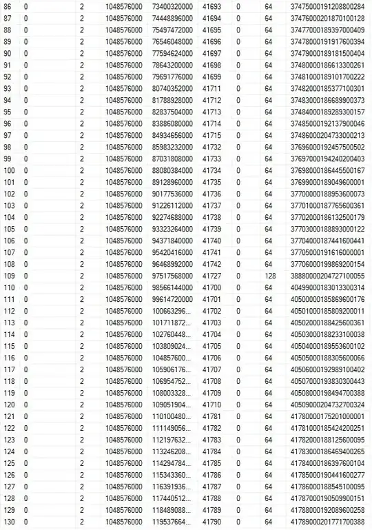

IF we look at lines 108 - 109, we see line 110 is written to first, then line 109, then line 108. Also the parity is off (not sure what this adds to the scenario) The LSN show they are created in the opposite order.
I would expect that once whatever caused the disruption in sequence order has passed, the next time through the VLFs would be written to in order created. Why are they not?
Notice line 86 is in both images, to show consistency. enter image description here

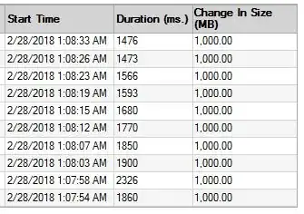

A couple of hours later the list looks this

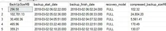

There is 115GB log file, with hourly backups. The VLF are all approximately 1GB and autogrowth set to create one new VLF of 1GB at each grow event. 2014 instance with a grow of less then 1/8 current size
After extensive searching and some testing, I find that log files always write sequentially (line 1,2,3,etc) EXCEPT when the next next VLF is still Status 2. The next write will occur on either the next available Status 0 VLF, or if there are none an autogrow will occur.
With Hourly t-log backups and out of order FSeqNo it means there were recently VLF remaining at Status 2 after the t-log backup ran (long running incomplete) With the order noticed at line 108,109 & 110 it is possible some VLF where not released through 2 backups.
Check the backups size on msdb..backupset to get more information, as this is an AG backing up on the secondary, run the following on the secondary server.
    --Find how big were the logs when backed up.
    SELECT database_name
    , CONVERT(varchar, CAST ((backup_size/1024/1024) AS MONEY), 1) as 'BackUpSizeMB'
    , user_name as 'BackUpBy'
    , backup_start_date
    , backup_finish_date
    , recovery_model
    , CONVERT(varchar, CAST ((compressed_backup_size/1024/1024) AS MONEY), 1) as 'compressed_backup_sizeMB'
    FROM msdb..backupset
    WHERE backup_finish_date > DATEADD(MONTH, -12, CURRENT_TIMESTAMP) -- If want month(s)

You will probably find something like this
enter image description here enter image description here enter image description here
There are recurring backups of around 100GB with fairly large backups on either side. In my instance I found that most t-log backups outside of these large events where about 500MB. Something runs for maybe 2 hours, and holds lots of VLF across backups. Then activity falls very low, and only a single VLF is cleared and the next taken. With configuration in the question it would take several days of low usage to return the expect straight forward sequence you might expect to find.
Next you will want check for auto growth, Kendra has a blog post that shows how to check This only works if there were recent events but you might find something like this.
There are several blog posts suggesting that "Optimal" VLF configuration is not more than 50 VLF at not more than 500MB (or 512) each. Obviously that only works for logs upto about 25GB.
In the scenario from the question. Each VLF is 1GB and there are hourly backups, additional the out of order FSeqNo indicate several VLF are locked at the time of backup. In the history shown in this answer (posted by OP from same database and instance in question) there is a 10GB auto grow in the minute before a 83GB t-log backup completed.
Optimally you don't want auto grows to occur, these only happen when the system is already strained. To address this you want to have sufficient space to meet recurring events, with anticipated pre-grows occurring off peak.
There are three options.
  1. PreGrow the logs (use backup history to estimate required space)
  2. Backup more frequently
  3. Create more smaller VLF using the same total log file space.
The option needs to be selected, considering the entire system configuration in your environment, there is no single right choice.
TL:DR Even with hourly backups, there is something locking VLFs from being reused. This may indicate strain in your current configuration. I recommend you identify the issue, decide if it is a recurring event and address appropriately.
