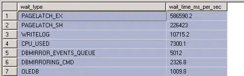

results as per david's query: Note@ below was run 15 mins after we did node failover
 wait_type  wait_time_ms_per_sec
PAGELATCH_EX    733024.4
PAGELATCH_SH    328846.4
CPU_USED    7131.4
WRITELOG    6484.4
DBMIRROR_EVENTS_QUEUE   4973.6
DBMIRRORING_CMD 1456.6
OLEDB   990.2
TRACEWRITE  984.2
SOS_SCHEDULER_YIELD 280.6
THREADPOOL  254
ASYNC_NETWORK_IO    45.4
LATCH_EX    9.4
PAGEIOLATCH_EX  7.6
PREEMPTIVE_OS_GETPROCADDRESS    3.4
MSQL_XP 3.2
DBMIRROR_SEND   1.4
PREEMPTIVE_OS_DELETESECURITYCONTEXT 1
PAGELATCH_UP    0.4
PREEMPTIVE_OS_WAITFORSINGLEOBJECT   0.4
PREEMPTIVE_OS_AUTHORIZATIONOPS  0.2
PREEMPTIVE_OS_AUTHENTICATIONOPS 0.2
SOS_RESERVEDMEMBLOCKLIST    0.2
CMEMTHREAD  0.2
Please provide additional troubleshooting suggestions and let me know if there are any further metrics needed.

  • @DavidBrowne-Microsoft-- Per your below answer i ran to find wait resource and found it to be under the user db where we see blocking as per db id and file id. I am not sure if i should be using trace 3604 to pull page and table info on PROD to be that safe? How should i proceed from here? – BeginnerDBA Feb 01 '18 at 22:25
This:
CPU_USED    7131.4
WRITELOG    6484.4
Shows that you have a latch contention problem, and only a latch contention problem.
Since
The CPU_USED row should be accurate. And so your workload is only managing to use 7sec of CPU time per second. This is like only running on 7 cores. In the mean time you have 1000sec of page latch time, meaning that you have, on average 1000 sessions waiting to latch a page, and only 7 performing useful work.
You are also running very old software on a very large server. The throughput on this server is pretty high, suggesting that the operation it supports is important. Also consider your username. So you should consider, strongly, engaging Microsoft Support or a partner with expertise in this sort of thing.
That said, the next step is to identify the source of your latch waits. Generally these are either on a hot page of a table in your database, or a system page in TempDb. The sys.dm_exec_requests.wait_resource should tell you which.
If tempdb, then Recommendations to reduce allocation contention in SQL Server tempdb.
If a table in your database, then post the DDL (including indexes) for the table and a the details of the queries that are blocking.
There is a whitepaper on diagnosing and resolving latch contention on SQL 2008 here: Diagnosing and Resolving Latch Contention on SQL Server

  • Thanks David, Could not find wait resource as there is no blocking going on since last night. Just updated the question as well – BeginnerDBA Jan 26 '18 at 21:33
51% of your wait is caused by PAGELATCH_EX and 23% is caused by PAGELATCH_SH.
There is some valuable information about this wait type at this post. I'm quoting a little bit here
This wait type is when a thread is waiting for access to a data file page in memory (usually a page from a table/index) so that it can modify the page structure (EX = EXclusive mode). The Latches Whitepaper in the sidebar on the right has a description of all latch modes and their compatibility with other latch modes.
Common causes of PAGELATCH_XX contention are:
  • Allocation bitmap contention in tempdb (PAGELATCH_UP for multiple threads trying to change the same bitmap), and under extreme loads,
    in user databases
  • Table/index insert hotspot (PAGELATCH_EX for threads inserting onto the same page and possibly PAGELATCH_SH for threads reading from that page)
  • Excessive page splits from random inserts (PAGELATCH_EX for threads trying to insert/update rows on a page and possibly PAGELATCH_SH for
There is a long article on troubleshooting PAGELATCH_XX waits on sqlperformance.com that covers the first two cases above, basically identifying the cause of the contention from the page resource involved and troubleshooting further from there. Troubleshooting the third case involves figuring out which index is undergoing the page splits and then usually implementing a fill factor and regular index maintenance. You can get the workflow for identifying a table from a page resource (from sys.dm_os_waiting_tasks) in this blog post.
