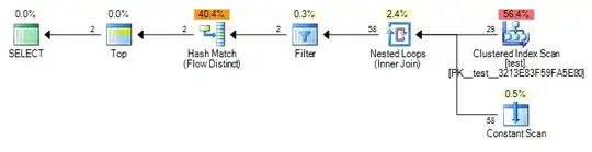

For @Thomas's answer I changed TOP 3 to TOP 2 to potentially allow it to exit earlier. I got a parallel plan by default for that answer so also tried it with a MAXDOP 1 hint in order to make the number of reads more comparable to the other plans. I was somewhat surprised by the results as in my earlier test I had seen that query short circuit without reading the whole table.
The plan for my test data that short circuits is below
Shortcircuits
The plan for ypercube's data is
Not Shortcircuit
So it adds a blocking sort operator to the plan. I also tried with the HASH GROUP hint but that still ends up reading all the rows
Not Shortcircuit
So the key seems to be to get a hash match (flow distinct) operator to allow this plan to short circuit as the other alternatives will block and consume all rows anyway. I don't think there is hint to force this specifically but apparently "in general, the optimiser chooses a Flow Distinct where it determines that fewer output rows are required than there are distinct values in the input set.".
@ypercube's data only has 1 row in each column with NULL values (table cardinality = 30300) and the estimated rows going into and out of the operator are both 1. By making the predicate a bit more opaque to the optimiser it generated a plan with the Flow Distinct operator.

One last tweak that occurred to me is that the query above could still end up processing more rows than necessary in the event that the first row it encounters with a NULL has NULLs in both column B and C. It will continue scanning rather than exiting immediately. One way of avoiding this would be to unpivot the rows as they are scanned. So my final amend to Thomas Kejser's answer is below
SELECT DISTINCT TOP 2 NullExists
FROM test T
CROSS APPLY (VALUES(CASE WHEN b IS NULL THEN 'b' END),
                   (CASE WHEN c IS NULL THEN 'c' END)) V(NullExists)
WHERE NullExists IS NOT NULL
It would probably be better for the predicate to be WHERE (b IS NULL OR c IS NULL) AND NullExists IS NOT NULL but against the previous test data that one doesn't give me a plan with a Flow Distinct, whereas the NullExists IS NOT NULL one does (plan below).

from T;
If this works (I haven't tested it), it would yield a one-row table with 2 columns, each one either TRUE or FALSE. I didn't test the efficiency.
