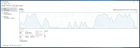

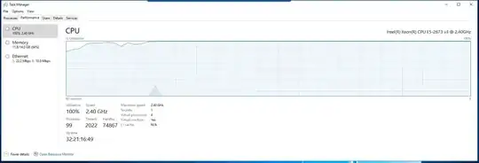

Here is a couple of screenshots showing whats going on.
CPU maxed out:
CPU running ok:
As you can see the server is quite powerful.

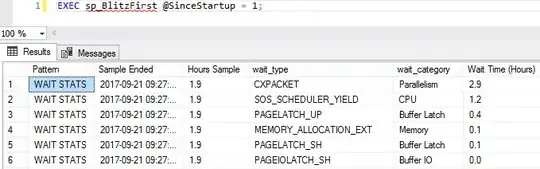

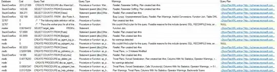

UPDATE: The following two screenshots are the results from the two queries @S4V1N suggested I run.

  1. Run sp_BlitzFirst
EXEC sp_BlitzFirst @SinceStartup = 1;
This will tell you what your server has been up to since it started up. Look at the wait stats pane to see where your bottlenecks are.

  1. Run sp_BlitzCache
EXEC sp_BlitzCache @SortOrder = 'cpu';
NUTS
Since you're concerned about your plan cache, look at it by CPU first. You may find other sort orders helpful down the line, but start here.
We'll warn you about all sorts of stuff in your query plans, and give you as much historical information as possible.
