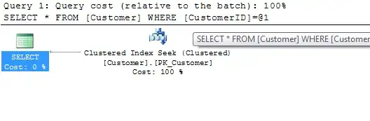

Right so if we execute the following query:
SELECT * FROM Customer WHERE CustomerID = 1
SQL will probably read the clustered index via a seek operation. A seek operation is a binary search which is much more efficient than a scan which is a sequential search. So in our above example the index is read and by using a binary search SQL can eliminate the data that don't match the criteria we are looking for. See attached screen shot for the query plan.
So the number of operations or O Notation for the seek operation is as follows:
  1. Do binary search on clustered index by comparing the value searched for to the values in the intermediate level.
  2. Return the values that match( remember since the clustered index has all the data in it can return all the columns from the index as it is the row data)
So it is two operations. However if we executed the following query:

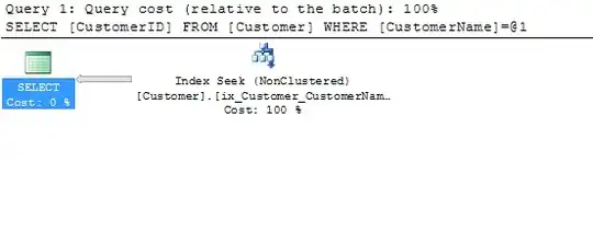

So just to clarify one last point. Why do I say that the pointer in the non-clustered index is the primary key value? Well to demonstrate that the leaf level nodes of the non-clustered index contains the primary key value I change my query to:
SELECT CustomerID
FROM Customer
WHERE CustomerName='Jane'
In this query SQL can read the CustomerID from the non-clustered index. It does not need to do a lookup on the clustered index. This you can see by the execution plan which looks like this.
Notice the difference between this query and the previous query. There is no lookup. SQL can find all the data in the non-clustered index
