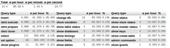

My database present status, it shows 41k insertions (writes), which is very slow for my database.
database status
