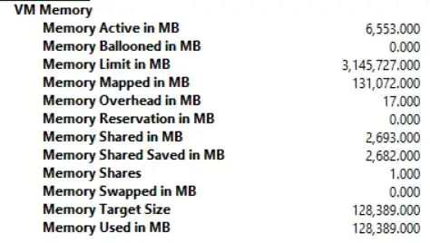

I suspect that perhaps VMWare plays some role here, but when I checked perfmon counters available from guest side, I haven't found anything suspicious.
VM Memory perfmon counters

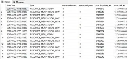

Finally I came across an article by Jonathan Kehayias and I decided to check ring buffers and boom!, it turns out that I have notifications from resource monitors saying: 'low physical memory'. Occurrences of this notification fit perfectly to the proc cache clearing. Now the case is how to interpret these results and how to find the reponsible process. As you can find in the query result:
SELECT
    EventTime,
    record.value('(/Record/ResourceMonitor/Notification)[1]', 'varchar(max)') as [Type],
    record.value('(/Record/ResourceMonitor/IndicatorsProcess)[1]', 'int') as [IndicatorsProcess],
    record.value('(/Record/ResourceMonitor/IndicatorsSystem)[1]', 'int') as [IndicatorsSystem],
    record.value('(/Record/MemoryRecord/AvailablePhysicalMemory)[1]', 'bigint') AS [Avail Phys Mem, Kb],
    record.value('(/Record/MemoryRecord/AvailableVirtualAddressSpace)[1]', 'bigint') AS [Avail VAS, Kb]
FROM (
    SELECT
        DATEADD (ss, (-1 * ((cpu_ticks / CONVERT (float, ( cpu_ticks / ms_ticks ))) - [timestamp])/1000), GETDATE()) AS EventTime,
        CONVERT (xml, record) AS record
    FROM sys.dm_os_ring_buffers
    CROSS JOIN sys.dm_os_sys_info
    WHERE ring_buffer_type = 'RING_BUFFER_RESOURCE_MONITOR') AS tab
ORDER BY EventTime DESC;
we can observe 'low physical memory' flag although value of Available Phiscal memory stays at the same level. Moreover if I am not misataken above results are indicating internal memory pressure (IndicatorsProcess = 2, which is weird to me as Sentry all the time shows that SQL Server doesn't fully utilize the allocated memory. This is memory usage captured by Sentry for sample taken at 8 AM:
Memory usage
All lines are pretty flat. What is also weird to me is that group of events:
  • RESOURCE_MEMPHYSICAL_LOW
  • RESOURCE_MEM_STEADY
  • RESOURCE_MEMPHYSICAL_HIGH
happens at the same time. So this pressure takes milliseconds or less (perhaps this is also the reason why Sentry doesn't capture anything as it collects data a way less frequently).
Now I wonder how to nail down the root cause of this memory pressure?
Best regards,
Greg

You've got a few different questions in here:
Does the "Lock Pages in Memory" setting preserve the plan cache? Only indirectly. LPIM means that SQL Server won't page out to disk if it comes under memory pressure, but SQL Server will still give up memory when the OS is under pressure. Jonathan Kehayias covers this in detail. The short answer is that when the box is under pressure, given your 16GB min memory setting, you would still see SQL Server giving up memory (and reducing the contents of the plan cache) even with LPIM.
Does SQL 2016 SP1 CU3 clear the plan cache periodically? Not in a way that's different from other versions. Your title suggests that you're seeing different behavior since you applied the CU - if that really is the case, your best bet there would be to uninstall the CU (go back to the previous CU2), and see if the behavior changes. I bet, though, that you're seeing a behavior that just happens to have started recently.
How do I see what's clearing parts of the plan cache? Since you wrote that the plan cache isn't entirely cleared, you need to see what databases/tables/indexes/stats are involved in the plans that are disappearing. For example, you may have a table that's hitting the 20% change threshold that triggers automatic stats updates.
Since it's not really an emergency, I'm going to give you the casual, low-labor-intensive approach I'd take to fix it. I would run sp_BlitzCache periodically (disclaimer: I'm one of the coauthors, although my code in there sucks pretty bad), getting to know the top 10 most resource-intensive queries. (Maybe even log it to table with the OutputDatabaseName, OutputSchemaName, and OutputTableName parameters.) Then, when the plan cache clears, run it and look to see what plans disappeared. Do they have something in common, like do they all hit a major sales table? If so, what's the change rate looking like on that table? You can use the rowmodctr to get a rough idea of which tables are changing how often.
Since you're using SQL Sentry, you can also set up a custom monitor based on this:
SELECT COUNT(*)
FROM sys.dm_exec_query_stats WITH (NOLOCK)
And that'll give you a line graph to identify when your plan cache is dropping. If it's happening at very specific intervals (like every hour), then I'd use the techniques in this answer to track down what's causing it.

  • Brent thanks a ton for prompt reply! I will give a try to LPIM anyway, I don't see much risk in introducing it as long as I keep max and min server memory configured. In terms of your second advice the post title is bit misleading, basically 2 weeks ago we migrated from SQL Server 2014 directly to SQL Server 2016 SP1 CU3 and since that time we have been observing this issue with the plan cache. – GrzegorzO Aug 01 '17 at 14:12
  • Last but not least I think the problem is not related to specific objects (I have updated original post including the output from sys.dm_exec_query_stats) altought not all plans go away at exactly the same time it looks like it's a majority (Just please refer to attached example, plans flushed at 15:38 except one created in cache at 15:33). – GrzegorzO Aug 01 '17 at 14:14
  • I found this issue accidentally by running sp_BlitzCache to see expensive queries which came up after mentioned migration into 2016. For now I don't see negative impact on performance, although I can imagine that sooner or later between one and another cache clearing some queries can generate sub-optimal plans in results of parameter sniffing, etc. – GrzegorzO Aug 01 '17 at 15:32
  • So eventually if LPIM doesn't change anything I will go for more pragmatic and as you said low-level intensive approach proposed by Brent. – GrzegorzO Aug 01 '17 at 16:10
  • I have updated orginal post with some new data indicating internal memory pressure – GrzegorzO Aug 02 '17 at 08:40
  • @GrzegorzO great! Yeah, that's what I figured - LPIM isn't going to help you at all there. Next up would be looking at things like the memory clerks (sys.dm_os_memory_clerks) to see which ones are consuming so much memory at the time. This has gone beyond what I can do quickly for free here at Stack though - now we're into some pretty advanced troubleshooting. You could call MS for support, or call SQL Sentry for assistance, or someone else may be able to donate more time to help. Glad I could get you started though. – Brent Ozar Aug 02 '17 at 12:43
  • Thank you so much @Brent I really appreciate your help! I will try to ask Microsoft for assistance, but we don't have premier support so I am not sure if they are going to help :( If possible please could you just give me some best guesses, you would start from trying to investigate such issue (just some ideas, no details, to give me some starting point for further work, I am afraid I am all alone with this anyway).
    BTW It was great experience to participate in your workshops in Wroclaw on SQLDay this year! It was brilliant!
    – GrzegorzO Aug 02 '17 at 13:07
Eventually, LPIM made a trick and solved / masked the issue, but the root cause is still uncertain and it might be even a bug in SQL Server.
If anyone is interested in further findings please navigate to the discussion on MSDN forum:
