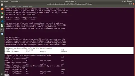

Remove the database and user access
goto this path and open pg_hba.conf and remove the user below the "Database administrative login by Unix domain socket" other than postgres database.
/etc/postgresql/10/main$ sudo nano pg_hba.conf or sudo nano /etc/postgresql/10/main/pg_hba.conf
after removing the user we got like this:
