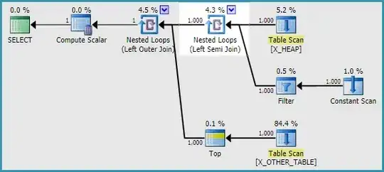

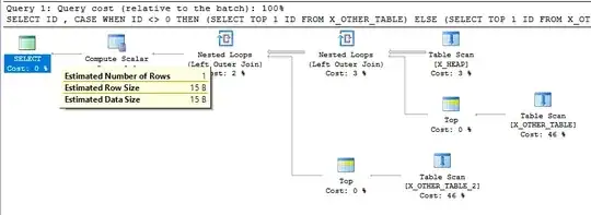

I would expect the final row estimate for this query to be equal to the number of rows in the X_HEAP table. Whatever I'm doing in the subquery shouldn't matter for the row estimate because it cannot filter out any rows. However, on SQL Server 2016 I see the row estimate reduced to 1 because of the subquery:
bad query
Why does this happen? What can I do about it?

In conclusion, we appear to get a bad row estimate after the subquery under the following conditions:
  1. The CSelCalcColumnInInterval selectivity calculator is used. I don't know exactly when this is used but it seems to show up much more often when the base table is a heap.
  2. Pass-through selectivity = 1. In other words, one of the CASE expressions is expected to evaluated to false for all of the rows. It does not matter if the first CASE expression evaluates to true for all rows.
  3. There is an outer join to CStCollBaseTable. In other words, the CASE result expression is a subquery against a table. A constant value will not work.
Perhaps under those conditions the query optimizer is unintentionally applying the pass-through selectivity to the row estimate of the outer table instead of to the work done on the inner part of the nested loop. That would reduce the row estimate to 1.

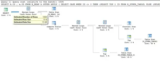

I was able to find two workarounds. I was not able to reproduce the issue when using APPLY instead of a subquery. The output of trace flag 2363 was very different with APPLY. Here's one way to rewrite the original query in the question:
SELECT
  h.ID
, a.ID2
FROM X_HEAP h
OUTER APPLY
SELECT CASE
    WHEN ID <> 0
    THEN (SELECT TOP 1 ID FROM X_OTHER_TABLE)
    ELSE (SELECT TOP 1 ID FROM X_OTHER_TABLE_2)
  END
) a(ID2);
good query 1

Using EXISTS introduces a semi join (highlighted) to the execution plan:
Semi join plan
The estimate for the semi join is fine. The problem is that the CE treats the associated probe column as a simple projection, with a fixed selectivity of 1:
Semijoin with probe column treated as a Project.
Selectivity of probe column = 1
This automatically meets one of the conditions required for this CE issue to manifest, regardless of the contents of the EXISTS clause.
