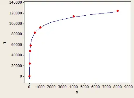

I tested on SQL Server 2014 with the legacy CE and did not get 9% as a cardinality estimate either. I couldn't find anything accurate online so I did some testing and I found a model that fits all of the test cases that I tried, but I can't be sure that it's complete.
In the model that I found, the estimate is derived from the number of rows in the table, the average key length of the statistics for the filtered column, and sometimes the datatype length of the filtered column. There are two different formulas used for the estimation.
If FLOOR(average key length) = 0 then the estimation formula ignores the column statistics and creates an estimate based on the datatype length. I only tested with VARCHAR(N) so it's possible that there's a different formula for NVARCHAR(N). Here is the formula for VARCHAR(N):
(row estimate) = (rows in table) * (-0.004869 + 0.032649 * log10(length of data type))
This has a very nice fit, but it's not perfectly accurate:
first formula graph
The x-axis is the length of the data type and the y axis is the number of estimated rows for a table with 1 million rows.
The query optimizer would use this formula if you did not have statistics on the column or if the column has enough NULL values to drive the average key length to below 1.
For example, suppose that you had a table with 150k rows with filtering on a VARCHAR(50) and no column statistics. The row estimate prediction is:
150000 * (-0.004869 + 0.032649 * log10(50)) = 7590.1 rows

If FLOOR(average key length) >= 1 then a different formula is used that is based on the value of FLOOR(average key length). Here is a table of some of the values that I tried:
1    1.5%
2    1.5%
3    1.64792%
4    2.07944%
5    2.41416%
6    2.68744%
7    2.91887%
8    3.11916%
9    3.29584%
10   3.45388%
If FLOOR(average key length) < 6 then use the table above. Otherwise use the following equation:
(row estimate) = (rows in table) * (-0.003381 + 0.034539 * log10(FLOOR(average key length)))
This one has a better fit than the other one, but it's still not perfectly accurate.
