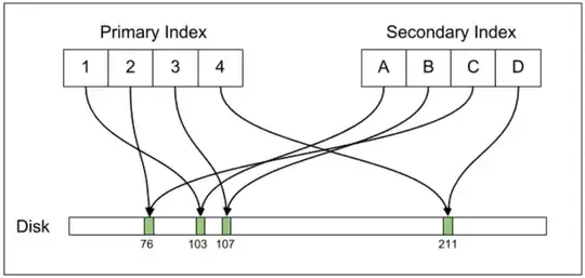

With regard to ctids, please note that performing and UPDATE (DELETE/INSERT from a physical standpoint) or VACUUM FULL will change a row's ctid. This does not bode well for tables with many indexes. Why ? This fact was recently discovered (July 26, 2016) by the Data Engineers at Uber.
Please note the following diagram (courtesy of Uber Engineering)
Index ctid Management
PostgreSQL does not cohesively couple a PRIMARY KEY with non-unique indexes. Since an index references a row by ctid, a simple UPDATE (even on a non-indexed column) will change the ctid, resulting in the need to rewrite the ctid in every index in the table that references that changed row. This is not something new. PostgreSQL has always done this by design.
Therefore, doing an UPDATE on 1000 rows will perform 1000 DELETEs and 1000 INSERTs. As already mentioned, every index attached to the table must have their new row ctid values written in the BTREE index entries, replacing the old row ctid value. Since you have no indexes on the table, you are just experiencing the DELETEs and INSERTs generating the deadlocks you see.
