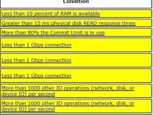

I am planning to add 3 new databases to an existing AAG cluster in a VM. The AAG has Veeam databases on it as of now. Veeam backups are not running on it as of now apart from a couple of batch processes of Veeam. I ran the PAL tool to figure out if memory was under pressure because SQLserver is consuming almost 93% of memory. I checked the page life expectancy and it looked OK. The Veeam team told me they had some performance issue and this is what i got from the PAL tool.

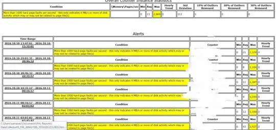

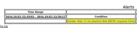

So I ran the following perfmon for almost a week, and this is where I am getting alerts. After changing the Max memory setting from default to 19gb
The following counters were run
• Memory: Available Bytes • Memory: Pages/sec • Process: Working Set • SQL Server: Buffer Manager: Buffer Cache Hit Ratio • SQL Server: Buffer Manager: Total Pages • SQL Server: Memory Manager: Total Server Memory (KB)

    what is the max memory and how many instances are running + Total RAM on the server ? What version of sql server you are using ? Is the network less than 1Gbps ? You also want to look at your disk latencies. – Kin Shah Oct 04 '16 at 13:10
  • Actually the min max memory settings for this server have been setup wrong. The max memory setting is 2147483647 megabytes, but the server only has 24575 megabytes. – buddinggeek Oct 04 '16 at 14:00
  • You are better off changing the max memory to a more sensible value. Also, depending on how busy the database is - 24GB RAM is not sufficient. – Kin Shah Oct 04 '16 at 15:56
  • Thank you. Do you think it's a good idea first to decrease the max memory, see how the application is working and then increase the physical memory size to accommodate the new databases? – buddinggeek Oct 05 '16 at 01:22
