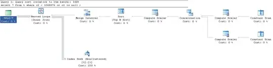

To my great surprise, the execution plan that was generated for this query, was this. (Sorry for the external link, it's too large to fit here).
Can someone explain to me what's up with all these "Constant Scans" and "Compute Scalars"? What's happening?
Plan
  |--Nested Loops(Inner Join, OUTER REFERENCES:([Expr1010], [Expr1011], [Expr1012]))
       |--Merge Interval
       |    |--Sort(TOP 2, ORDER BY:([Expr1013] DESC, [Expr1014] ASC, [Expr1010] ASC, [Expr1015] DESC))
       |         |--Compute Scalar(DEFINE:([Expr1013]=((4)&[Expr1012]) = (4) AND NULL = [Expr1010], [Expr1014]=(4)&[Expr1012], [Expr1015]=(16)&[Expr1012]))
       |              |--Concatenation
       |                   |--Compute Scalar(DEFINE:([Expr1005]=NULL, [Expr1006]=NULL, [Expr1004]=(60)))
       |                   |    |--Constant Scan
       |                   |--Compute Scalar(DEFINE:([Expr1008]=NULL, [Expr1009]=(1048576), [Expr1007]=(10)))
       |                        |--Constant Scan
       |--Index Seek(OBJECT:([t].[i]), SEEK:([t].[c2] > [Expr1010] AND [t].[c2] < [Expr1011]) ORDERED FORWARD)

The constant scans each produce a single in-memory row with no columns. The top compute scalar outputs a single row with 3 columns
Expr1005    Expr1006    Expr1004
NULL        NULL        60
The bottom compute scalar outputs a single row with 3 columns
Expr1008    Expr1009    Expr1007
NULL        1048576        10
The concatenation operator Unions these 2 rows together and outputs the 3 columns but they are now renamed
Expr1010    Expr1011    Expr1012
NULL        NULL        60
NULL        1048576     10
The Expr1012 column is a set of flags used internally to define certain seek properties for the Storage Engine.
The next compute scalar along outputs 2 rows
Expr1010    Expr1011    Expr1012    Expr1013    Expr1014    Expr1015
NULL        NULL        60          True        4           16
NULL        1048576     10          False       0           0
The last three columns are defined as follows and are just used for sorting purposes prior to presenting to the Merge Interval Operator
[Expr1013] = Scalar Operator(((4)&[Expr1012]) = (4) AND NULL = [Expr1010]),
[Expr1014] = Scalar Operator((4)&[Expr1012]),
[Expr1015] = Scalar Operator((16)&[Expr1012])
Expr1014 and Expr1015 just test whether certain bits are on in the flag. Expr1013 appears to return a boolean column true if both the bit for 4 is on and Expr1010 is NULL.
From trying other comparison operators in the query I get these results
| Operator | Expr1010 | Expr1011 | Flags (Dec) |       Flags (Bin)       |
|          |          |          |             | 32 | 16 | 8 | 4 | 2 | 1 |
| >        | 1048576  | NULL     |           6 |  0 |  0 | 0 | 1 | 1 | 0 |
| >=       | 1048576  | NULL     |          22 |  0 |  1 | 0 | 1 | 1 | 0 |
| <=       | NULL     | 1048576  |          42 |  1 |  0 | 1 | 0 | 1 | 0 |
| <        | NULL     | 1048576  |          10 |  0 |  0 | 1 | 0 | 1 | 0 |
| =        | 1048576  | 1048576  |          62 |  1 |  1 | 1 | 1 | 1 | 0 |
| IS NULL  | NULL     | NULL     |          60 |  1 |  1 | 1 | 1 | 0 | 0 |
From which I infer that Bit 4 means "Has start of range" (as opposed to being unbounded) and Bit 16 means the start of the range is inclusive.
This 6 column result set is emitted from the SORT operator sorted by Expr1013 DESC, Expr1014 ASC, Expr1010 ASC, Expr1015 DESC. Assuming True is represented by 1 and False by 0 the previously represented resultset is already in that order.
Based on my previous assumptions the net effect of this sort is to present the ranges to the merge interval in the following order
 ORDER BY
          HasStartOfRangeAndItIsNullFirst,
          HasUnboundedStartOfRangeFirst,
          StartOfRange,
          StartOfRangeIsInclusiveFirst
The merge interval operator outputs 2 rows
NULL        NULL        60
NULL        1048576     10
For each row emitted a range seek is performed
Seek Keys[1]: Start:[dbo].[t].c2 > Scalar Operator([Expr1010]),
               End: [dbo].[t].c2 < Scalar Operator([Expr1011])
So it would appear as though two seeks are performed. One apparently > NULL AND < NULL and one > NULL AND < 1048576. However the flags that get passed in appear to modify this to IS NULL and < 1048576 respectively. Hopefully @sqlkiwi can clarify this and correct any inaccuracies!
If you change the query slightly to
select *
from t
where
      c2 > 1048576
   or c2 = 0
Then the plan looks much simpler with an index seek with multiple seek predicates.
The plan shows Seek Keys
Start: c2 >= 0, End: c2 <= 0,
Start: c2 > 1048576
The explanation for why this simpler plan cannot be used for the case in the OP is given by SQLKiwi in the comments to the earlier linked blog post.
An index seek with multiple predicates cannot mix different types of comparison predicate (ie. Is and Eq in the case in the OP). This is just a current limitation of the product (and is presumably the reason why the equality test in the last query c2 = 0 is implemented using >= and <= rather than just the straightforward equality seek you get for the query c2 = 0 OR c2 = 1048576.

    @MartinSmith 60 is indeed for a comparison with NULL. The range boundary expressions use NULL to represent 'unbounded' at either end. The seek is always exclusive i.e. seek Start: > Expr & End: < Expr rather than inclusive using >= and <=. Thanks for the blog comment, I'll post an answer or a longer comment in reply in the morning (too late to do it justice right now). – Paul White Mar 12 '12 at 14:59

The constant scans are a way for SQL Server to create a bucket into which it's going to place something later in the execution plan. I've posted a more thorough explanation of it here. To understand what the constant scan is for, you have to look further into the plan. In this case, it's the Compute Scalar operators that are being used to populate the space created by the constant scan.
The Compute Scalar operators are being loaded up with NULL and the value 1045876, so they're clearly going to be used with the Loop Join in an effort to filter the data.
The really cool part is that this plan is Trivial. It means that it went through a minimal optimization process. All the operations are leading up to the Merge Interval. This is used to create a minimal set of comparison operators for an index seek (details on that here).
The whole idea is to get rid of overlapping values so that it can then pull the data out with minimal passes. Although it's still using a loop operation, you'll note that the loop executes exactly once, meaning, it's effectively a scan.
ADDENDUM: That last sentence is off. There were two seeks. I misread the plan. The rest of the concepts are the same and the goal, minimal passes, is the same.
