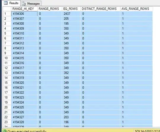

I thought I had solved my own issue: It looks like you have to have a clustered index with a distinct set of ranges to get SQL Server to split the files into partitions. But right now my index seems to have 0's for all ranges.
DBCC SHOW_STATISTICS
